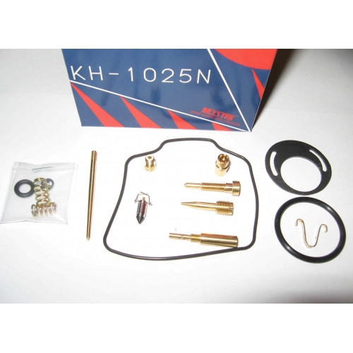

Voici le kit :
Keihin PC type carb. Contains MJ#92, PJ#35, jet needle 18234 [D22] and needle jet, float bowl o-ring seal, rubber tipped needle valve, pilot mixture screw and spring etc

Voici le kit :
